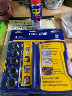

Had my John Deere lawn tractor worked on 18 months ago for a major repair. Part of the service included blade sharpening. Tech must have over torqued with impact wrench the bolts that hold blades on spindle. The tractor has some age and bolt heads were somewhat worn making socket hard to grip. I sharpen my own blades and could not get the bolts loose. Manual calls for no impact wrench usage and 39 foot ponds torque. I finally bought an Irwin Brand Bolt Gripper sockets and WD40 penetration spray. Sprayed bolts and waited 10 minutes. Used the grip socket (see picture) and put a lot of muscle behind it and finally bolts came loose. Recommend these sockets for damaged bolts or nuts. $28 bucks at Lowe’s and $3 for penetrating spray. $ 31 - Saved me a trip to the dealer or service call.

Thanks for the heads up on that Irwin set. It's always nice when something works as advertised. On my next Lowes trip, its going in the cart.
Saw both at Lowe’s but the small spray WD40 Specialist Penetrant was cheaper. All others in big cans. This is not the same as regular WD40. Thought I would give it a try. Lowe’s did have Kroil.
I had a large bolt and nut assembled on my neighbors fancy pick up truck that we needed to take apart. I first tried a combination wrench, then a 3/8" ratchet, then went to a 15" breaker bar - no luck. Tried Kroil, waited, then added heat - no luck! Finally I broke out my air operated 1/2" drive Snap-On impact wrench and the bolt came off like a piece cake! This nut and bolt was not having any manual hand tool budge it. Since living here in SWFL I have seen a few really super stubborn fasteners - guess it has something to do with the climate.
I have heard good things about the sockets you are talking about. I do not own any but am thinking of soon. That said, sometimes impact can trump pure gripping strength.
