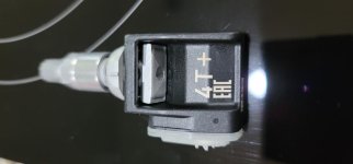

You can buy brand new sensors on eBay (you just gotta know which ones you need). I got 4 for my travel trailer and the truck's display has a separate reading for the trailer tire pressure. It even gave instructions on how to set them up in the truck's computer. All 4 cost me $96 and I had them mounted when I replaced the trailer tires so installation was essentially free. They are genuine GM and exactly the same ones as my truck uses.
Ever since I had two blowouts on a single trip on my camper (my trailer tires overheated and I didn't have any warning) I'm completely sold on the need for TPMS. It's quite exciting to have your 8500lb travel trailer blow tires on the interstate at speed! If I had TPMS on them at the time I could have seen the pressures rise as the tires heated up and known to slow down.
