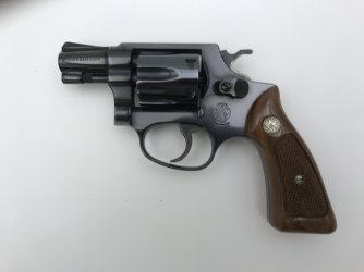

I was curious as to what a 3" round butt model 31 would be worth, ball park value as gun would be in 90% condition, no box

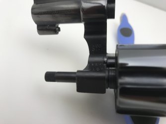

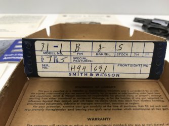

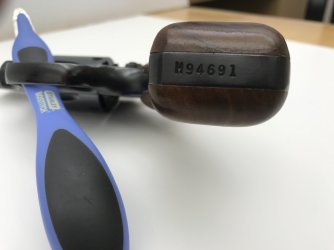

Be careful when thinking C&R, it is not just the year. My 31-1 has the box and all documents, plus I have the original sales receipt from gun store to original owner which is where I bought the gun to settle the original owners estate. So I know for fact it sold in 1975, but I asked Roy Jinks for the original ship date which was in September 1975 for my serial number H 94691.
To be C&R the gun must be fifty (50) years old, buy today being July 11, 2025 mine won't technically be C&R for a couple more months. Splitting hairs??? Probably but I've never had the BATF come knocking on my door either.
I would say take no ones' word for it, it's your C&R license, do your due diligence, join Smith & Wesson Historical Foundation and ask Roy Jinks or other SWHF Historians for the factory records ship date, especially when it is close like this.
