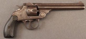

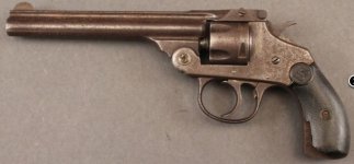

Anybody know how old this is or where to get parts? It looks alot like a S&W top break. .32 S&W don't have a serial number, scared the grips will fall apart if I take them off LOL. Are these worth hunting down or making parts? Any info will be greatly appreciated.

My dad had one like this, it's an Iver Johnson in .38 S&W, not to be confused with .38 S&W Special.
The only difference if my dad's was DAO with a shorter barrel.
If this is a .32, it is indeed a revolver made by Iver Johnson.
The US Revolver Co. name was an economy line of .32 and .38 topbreaks made in the 1910s and 1920s by Iver Johnson concurrently with their own eponymous line of guns. There is no connection to S&W.
The long barrel is uncommon.
I suspect there are some experts here who know more about these but just haven’t seen the thread yet.
PS: Here is an old summary post I found by the late Bill Goforth, the expert on all things Iver Johnson:
“U.S. REVOLVER CO. AUTOMATIC HAMMER-------------------------1910-1935
LARGE FRAME AND SMALL FRAME DOES NOT HAVE HAMMER THE HAMMER ACTION; This is a Brand name revolver manufactured by Iver Johnson’s Arms & Cycle Works to be sold through the wholesale trade. It was never listed in any Iver Johnson’s Arms & Cycle Works catalog, although it was listed in some European catalogs as original Iver Johnson products. Does not have Hammer the Hammer action and relies on a safety notch on the hammer. Hard rubber grip panels with U S at the top, large oversize two piece hard rubber grips were optional....”
As Absalom stated, US revolver was a cheaper line of Iver Johnson handguns. The actual serial number will be on the frame, under the left grip (sometimes there is a number on the trigger guard, it is normally only part of the full serial #). If the cylinder and barrel are sound the other parts are available and with a little patience they can be fixed. Collector value is low, especially if not in top shape so really only worth it if you like to tinker.
I've worked on a few of these and also the Iver Johnson of the same vintage. I've gotten many parts for these and Iver Johnson pistols on Numrich Gun Parts and also eBay on occasion.
When looking on other sites, these US Revolver Co. use the same parts as the 3rd Model Iver Johnson, which were made from around 1897 to 1908 or so and were for black powder loads. They use the same flat springs and such, but the US Revolvers don't have the safety block, or Hammer the Hammer, piece in them, which means the firing pin is on the hammer on US Revolvers. These also have free wheeling cylinders, so don't let that throw you! Once IJ went to top breaks that could handle smokeless powder, they also incorporated a coil mainspring and a cylinder stop that changed the look of the cylinder lock-up and are easy to spot the difference when you see them. All the US Revolver Co pistols were made from about 1910-1935ish and had no changes made to them at all. They changed from flat springs, nor did they put in a cylinder stop.
I found these pretty easy to work on, once you get the hang of it, but slave pins are a must.
As mentioned, they do not have much collector value. I just purchased an IJ 3rd Model a few weeks ago in excellent shape for a whopping $150. US Revolver Co. pistols usually go for a bit less than Iver Johnson ones.
