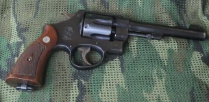

I have a buddy who lives very close to the store. He snapped this picture.
From what I can see in the picture I'm a lot more interested than I was by the description. If the SNs all match, including the one on the left side grip panel, I'd probably be trying to buy it. Good luck.
