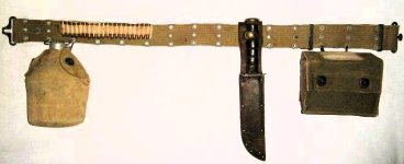

Since that USN pouch only held six rounds, some were "rigger-modified" to hold more rounds. In addition, the US M1936 web belt itself was also rigger-modified to add ammo loops; usually with web material, but also with leather. See pictures.

Be aware that the Navy had an alternate ammunition pouch. According to the Bureau of Ordnance Catalog of Navy Material dated July 1945, an accessory for the Victory Model revolver was the "...POUCH, First Aid packet (used with the revolver as ammunition carrier)". Those pouches are still plentiful and easy to find and would be entirely authentic as an ammo carrier on a Victory belt rig.
