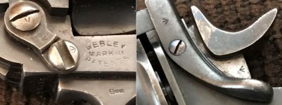

The other way round in my case:
I have a .455 Mk. III, unfortunately shaved. Haven't gotten around to finding ammo and/or half-moon clips yet.
An 1899 vintage, Army contract; they put broad arrows on every small part!
Boer War provenance. 6th Ammunition Column, Royal Artillery, deployed to SA by April 1900.
