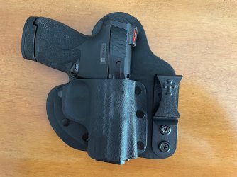

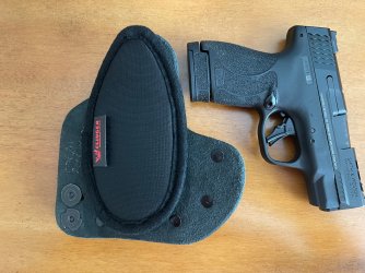

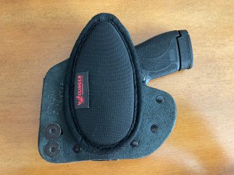

Here are some photos of a wedge that I have constructed for my newly purchased Phlster Enigma Express. (The Phlster Enigma is quite a topic in itself. It's a system for carrying AIWB concealed without relying on your pants belt. It requires a fair amount of trial and error, fiddling and tweaking, to work well, but, when it works well, for many, it is a great solution. I've been trial and erroring for about two weeks now, and think I am close to having it dialed in.)
Phlster sells two sizes of wedge. I found the large too large, but the small, when I added a piece I cut from a piece of polyethylene foam, just right. Had to experiment a bit with the size of the polyethylene foam piece. I think most guys just make their own wedges. The velcro is easily cut to size, and has a sticky side so easy to attach.

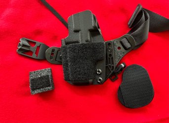

Cphobes, I'd be interested in seeing your set up if you care to post a pic, and hearing an explanation of what it is, the different elements, and how in combination they work for you.
E.g., ride height, with the holster on a belt, must be a function of how you wear your pants, or the cut of the pants, it seems to me... And I'm thinking the importance of cant must be about accommodating, taking advantage of, the inguinal crease.

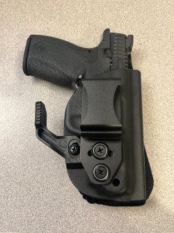

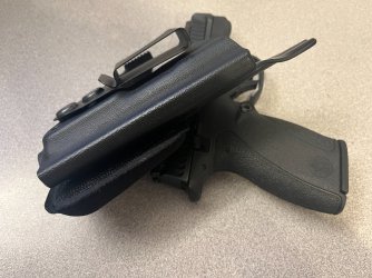

So, I actually have carried this ALL day without any complaints AIWB. I can carry AIWB or strong side with this holster though I prefer AIWB. I've tucked it under a dress shirt with no over garment (jacket) and carry under an untucked shirt. I always wear an undershirt as well which goes between me and the AIWB hoslters.
Firearm: S&W Bodyguard 2.0
Holster: Vedder LightTuck Kydex IWB
Belt Clip: 1.5"
Claw: Added during order
Wedge: Added during order
So, this is a pretty "stock" AIWB holster including the claw and wedge. I like the vedder belt clip enough that I purchased additional ones that have a different length for another holster, so that helps with the ride height and cant adjustments.
This is a SMALL holster, since its a SMALL firearm.
I carry this "low" on my belt (using higher holes) which means that the grip of the pistol is very close to my belt. This does mean it takes more effort to draw from the holster, but this is for deeper concealment. My only complaint is that this has limited height adjustment, but with this pistol I don't see that as a problem.
I've found their wedge to be ok in size, I tend to like them slightly thicker on my heavier Shield Plus in AIWB but this works fine with the lighter BG2.0 and holster combo.
It is not cut for an optic, but at the time I don't believe they offered it (Jan, 2025). If I were to get an Optic mounted I understand I'd have to cut away enough keydex along the top (non-critical portion) to get it to seat correctly. Would require about 1/2" along the top to be removed.
It does have a full sweat guard and the claw is far enough away that it doesn't scrap my knuckles on drawing.
There are MANY other manufacturers that have similar setups, I'd like one that has more adjustments for height. Where the holes are on the holster dictates which loops and clips you can use with which holsters. I have a bunch of holsters and parts!
While the mag release is exposed, I've never accidentally activated it, I carry only 10rds (not 10+1), so there's one in the chamber and the mag has 9 rounds in it.
Hope that helps!

Thanks, Cphobes. I appreciate the explanation and the pix.
When you say you've "tucked it under a dress shirt with no cover garment," do you mean you've worn it with a dress shirt tucked in? If so, the clip on the belt is then all that can be seen by an unusually observant observer?
Is the exposed clip a problem, do you think, or maybe no one is ever that observant to notice?
And hard is it to draw like that? (I'm thinking the tails on a dress shirt are pretty long, and snatching the front of the shirt up and away could be difficult...)
Does Vedders offer different thicknesses/sizes of wedges and claws, and the customer experiments until he/she gets it right?
Hello, yes dress shirt tucked in. I usually roll that edge a few times so it tucks neatly behind the clip.
The clip is visible, and against a brown belt it is noticeable to an observant observer. Though they’d be staring at your belt buckle or crotch to have to notice it. The shirt can be slightly baggy at that point to help with not printing. I don’t think this is an issue and most often I’m wearing a jacket but it can work without the jacket.
When drawing yes, you will need to clear the garment which will take more effort. The low height and garment will make for longer draw times. Though with adrenaline etc I don’t see this as prohibitive. You might damage the dress shirt with over exuberance but again not prohibitive.
I don’t know what else Vedder offers, though any additional components will be at a cost. I think they offer different wedges though not likely claws on a small holster. I buy parts on Amazon and not all are interchangeable. I’d go to their website and look. Their customer service was very helpful when I contacted them.

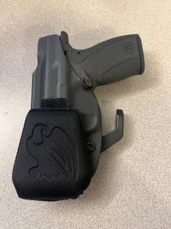

A "wedge" or "cushion" is a big help when carrying AIWB. It tends to put the grip at a better angle for drawing and re-holstering and makes the holster more comfortable to wear and tight to the body. I put a Clinger Cushion on my CrossBreed AIWB holster for my PC Shield Plus 9mm. I noticed that my "dunlop's disease" (my belly done lopped over my belt) was beginning to interfere with my EDC, and the cushion definitely helped with that. I have dropped about 15 lbs. in the past few months and it's even more comfortable now.
Haw Rider, looking at the positioning of the wedge in your holster, it looks to me like you set it up to push the grip of your pistol away from your body (and avoid that belly droop interfering with your grip that you mention).
If you add an additional wedge, as you can see in my pix in post #1, I think it would move the muzzle out from your body as well, which might be more comfortable.
