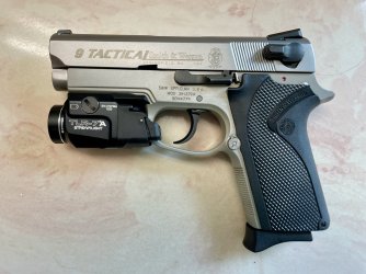

I have a TLR-7A on my 3913 and it’s fairly snug on the factory bolted on rails. I also have a WVSP 4566 TSW with a TLR-1 HD with the Glock insert and it fits like a glove. Here’s my 3913
