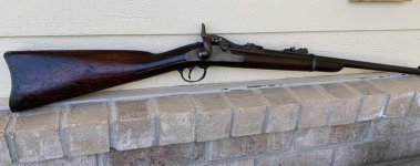

Ok, I have an original 1873 trap door and a brand new Henry lever action. I want target ammo for now. Can they both handle the same load? I know the Springfield has not been shot in a hundred years but looks excellent. What is cowboy action ammo 500 grain? I have no idea.
Stick to lead cowboy loads with lead bullets only in the trapdoor. Jackets bullets will prematurely wear your rifling out.
Take a look at some reloading sources, even if you don't reload. There are essentially 3 pressure levels for .45-70: 1) Trapdoor; 2) Modern lever actions like Marlin and Henry; and 3) Ruger #1 or similar falling block design. Your Henry should handle pressures just fine at 30000 psi (maybe more?). Marlins can easily handle 35000 psi. Your trapdoor should be kept closer to black powder levels, say a 405 gr pill around 1300 fps or so.
I would assume Cowboy action ammo is loaded at trapdoor levels, but check the rated muzzle velocity on the box. Anything at 400+ gr and 1500+ fps I would probably not run through your trapdoor.
Just use some Common Sense ... the trap door was designed when black powder and lead bullets were the only ammo ... So Low Pressure or black powder ammo only .
Consult Henry about the brass framed Lever action ... I don't have info on that one and don't want to steer you wrong .
Be careful , Stay Safe

You haven't said whether the 1873 was a rifle or a carbine. Also, what manufacture date are you looking at? IIRC, the early carbines had a different loading than the rifle. There are threads on the forum and other places about this.
I tried to load a Black Hills 45-70 cowboy round in my early 1873 carbine (serial range 12K) and it wouldn't chamber fully. That's when I learned about the early carbine loads.
I ultimately decided not to shoot my carbine due to it's early serial number (pre-Custer). I didn't want to take any chance on damage.
All of the cowboy loads I see are 405 grain lead bullets loafing along at about 1300 fps. They still give a solid thump out of a carbine.
Even though I dislike reloading, I still bought a classic Lee Loader in .45/70 just to see if I can get the bullets to hit nose first. Now if I can find some .459 bullets and large rifle primers I'll be all set.
Thanks for all the replies. My 1873 Trap Door is the original big mama Jama no carbine. I appreciate all the info. My local gun shop owner is old like me. Maybe it would be best to take it to him. If for no other reason a safety inspection. It came from the battlefield of Chattanooga Tennessee. Been in the family since 1907 and never fired. Even has the original leather sling and cleaning rod.
