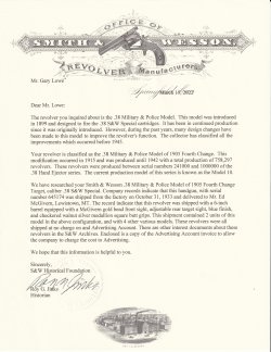

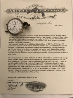

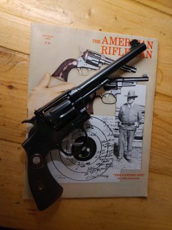

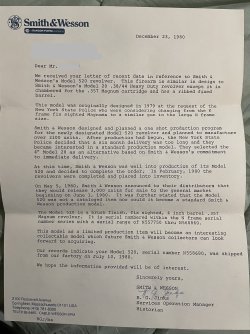

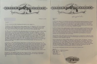

I have to add that there are apparently many who do not get letters for their guns. What I do like is buying a gun with a letter confirming that the gun I am buying left the factory in that same configuration. Provenance is important to some, answer mysteries to others and when lucky, end up like the previously unknown gun that I had lettered, below, that shipped to Ed McGivern!
