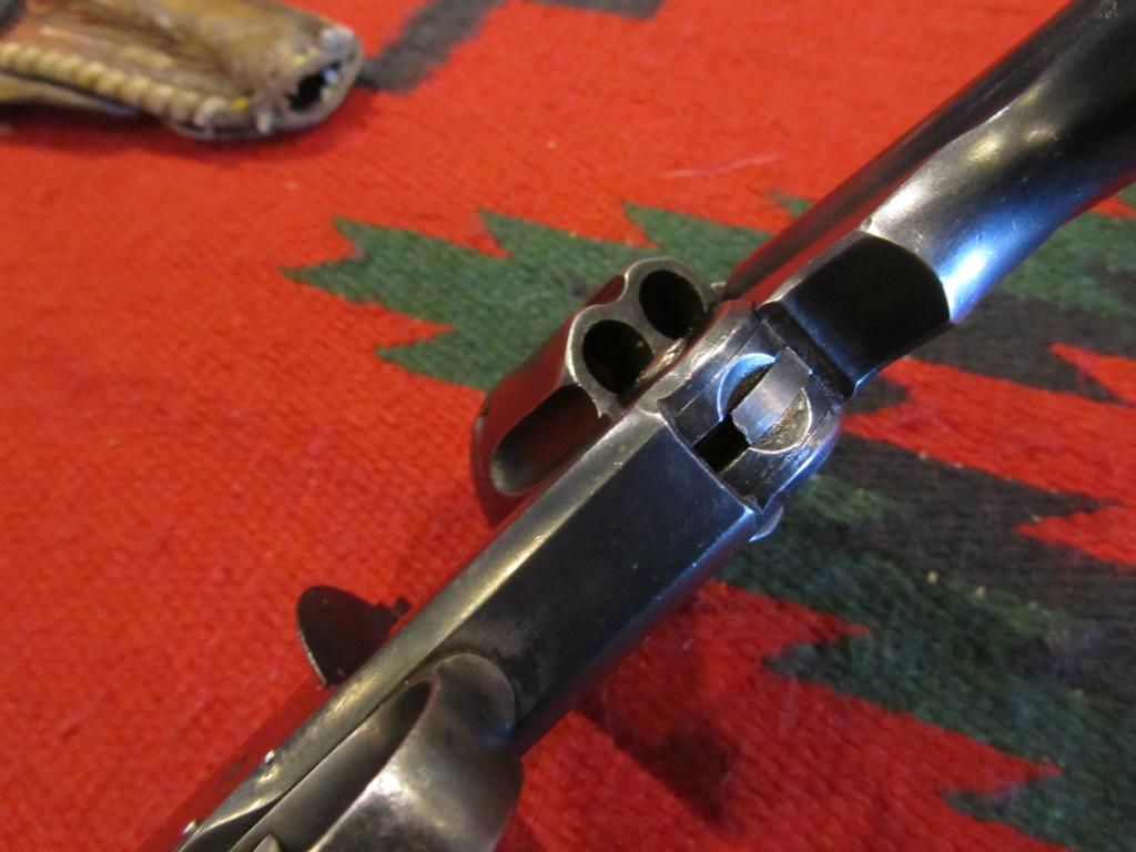

I now have two Model 3's in 44 Russian. Still new to these pistols and still researching them. Serial numbers 21xx and 52xx. The 52xx pistol has a broken part - perhaps someone could direct me to a parts supplier for these pistols? I don't know the part name but it is the center ring of the barrel pivot.

http://i788.photobucket.com/albums/yy162/ebeeby2010/Guns/NMNo3complete_zps735b22aa.jpg
http://i788.photobucket.com/albums/yy162/ebeeby2010/Guns/NMNo3brokenratchet_zps456796be.jpg
http://i788.photobucket.com/albums/yy162/ebeeby2010/Guns/NMNo3nickel_zps473a89e4.jpeg
Thanks for your fast reply. I believe these to be New Model no3 pistols. In the one photo, you can see that the ratchet ring is broken. I don't think this is the same ratchet shown in the link you provided (I could be wrong)

You do have a New Model 3 SA in 44 Russian, and you are correct, the standard ratchet fits every model but yours. I would still check with David Chicoine and you can post a WTB accessory on this board. There is also Jack First, but you have to buy the catalog or call, as they do not have much online.

Since you have another Model 3 with a functioning ratchet, you may have to find a machinist and have one made. He can use one for a pattern and make another. It is not too difficult to fabricate a ratchet, but will probably not be cheap.

Yes, I had thought of that. I'll see if the group who will be "un-boogering" the screws on the blued gun can fabricate a ratchet using the nickel gun part as a template.

Thanks for the heads up. Not sure if the part listed, which is stated as 1st and 2nd model, will work in the New Model 3. Expecting the broken ratchet pistol via fedex today. I'll pull the ratchet ring to see if it is the same.
Thanks again.
Just disassembled the NM no3 and after removing the insert, the broken ratchet ring looks exactly like the ones listed. I have an email into the seller to ask if he has any positive info that his ratchet rings will NOT fit the NM no3.
Ha! This NM no3 has a broken ratchet ring from a No1 or No2 in it! So I am still on the hunt for a ratchet ring for a NM no3.
