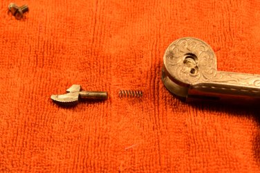

Hi There,
Welcome to the Forum!

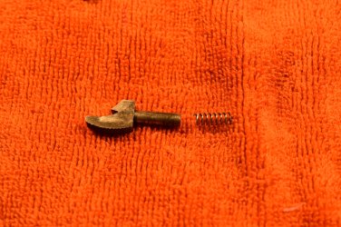

I take it you have a S&W Russian 2nd Model. This model used the same
ejector gear catch as the 2nd Model American. Here are a few pics of the
parts.
Cheers!
Webb

Hi There,
Here is a pic of the relationship between the catch and the gear.
Cheers!
Webb

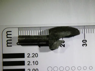

hi Webb; heres a shot of the ejector cam- looks different from the one you supplied and also has a little slot for a spring in there where presumably the nose of the ejector spring piston would dock, and 10 teeth vs 8 but both have a 100 thou interval between the tooth tips. It is 156 thou thick and there is also an odd little round slot at one end of the arc of gears. The inner race of the bearing is 220 as opposed to 225 on my other ejectors. Bit of an oddball and as is it does not operate the ejector properly. I will probably use your images to make a copy and try that. If you have an image of your base pin bushing for the cylinder and your ejector rod I could compare those and see if the other bits with the gun are also not quite right, Thanks again for your generous help.
best regards Chris

Hi There,
WOW! That is an interesting modification to your gear. I have no idea
what the purpose was but I wonder if there were other modified parts
that went with this modification. It sure appears this was an original gear
that was used.
In response to the smaller ID in your ejector gear bushing, it should be
only 1 or 2 thousandths larger than the barrel pivot to minimize looseness
and improve functionality.
There is a seller that is offering wire EDM made ejector gears for these.
I purchased one of them and they are NOT a drop-in part and you will
have to do some fitting. Mine was a couple thou. too think and the bushing
had the wrong ID. But it wasn't much trouble for me to make the adjustments
necessary to achieve a proper fit and function (I have a small garage machine
shop). In fact, the gear in my pics is one of those EDM replacements. They
are not cheap (at $199.95 each). I will send you a PM with a link (I don't think
the rules allow the posting links to active auctions or 'for sale' adds).

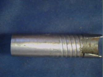

The cylinder rotates on the base pin which is a hollow axle which is screwed
securely into the barrel. This is an easily broken part if you try to remove it.
Be Careful.

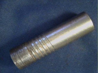

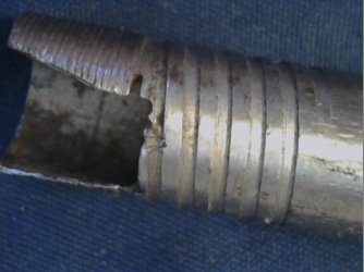

Hi There,
Well, I can make a start. Here are some pics of the Base Pin. The damage
is typical of what can happen when removing the base pin from the barrel.
Cheers!
Webb

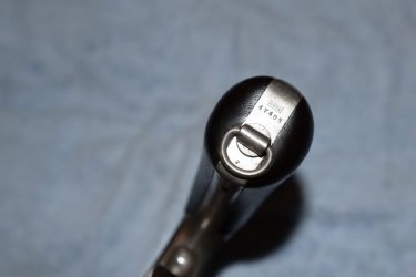

This gun also looks like the frame and barrel/cylinder are notmatched. I am a bit suspicious that the barrel and cylinder are modern, the blue is gorgeous and the cylinder has a nice gold inlay. On the underside of the barrel latch is a 4 digit code (illegible number) then 579. The cylinder caliber is 470. The sight is cast as part of the barrel, not seperate
There are no marks on the barrel and cylinder other than a tiny backward P on the underside of the ejector housing.
The barrel top marking is (cross) Smith&Wesson Springfield Mass USA PattJuly 10 60 Jan 17 Feb 17 July 11 65 & Aug 24 69 Russian Model (cross).
The frame and butt are more worn finish and the butt is marked with 1874 in a box and mismatched number 47747.

Hi There,
Your latest Russian is a 3rd Model. These used a completely different extractor
system (although it is still a rack-n-pinion type). The letter "P" is not familiar to
me but I suspect the barrel may have been a Russian reject and S&W being a
thrifty Company, would sometimes re-use a rejected part on a domestic revolver
so long the reason for rejection didn't impair function or safety. Plus, it just may
have been a left over from the Russian Contract and not a reject at all.
I am a fan of Kroil but I have used a 50/50 mix of Acetone and ATF for soaking
large items.
The numbers you are encountering are called "assembly" or "fitting" numbers.
When a work order came down to the assembly dept. to fill an order, the assembler
would get a frame (previously machined and grips and serial number assigned). and
take it back to his workbench. Then he would collect the necessary parts (most are
already on his bench) and assemble the revolver. Sometimes, the first part tried
didn't fit exactly right so he tried another one until he gets the proper "fit" he wants.
Then the major parts are mark with a "fitting" number. This number was stamped
on the side of the frame near the heel under the right-hand grip panel, The back
of the cylinder, The underside of the barrel latch and the back of the barrel (in the
cutout for the latch). This number should match on the 4 major parts of the gun.
