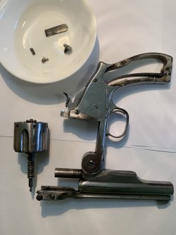

I found a disassembled a SW No 3 44 Russian that I bought. The cylinder is separated from the ejector rod as well as the stop cylinder plate and screww, barrel block platebarrel block screw, barrel block plunger. Everything looks to be in good shape for reassembly, but I cannot find a manual or any instructions for reassembly. I used a Uberti Russian schematic for the part names, which looks the same; it's the reassembly that I'm not sure of. Any assistance would be greatly appreciated.

Thanks for the reply. I hate to admit I don't have the camera skills to take or post photos. I'll see if I can find a youngster to help.
As you can see its in good shape and everything looks to be there except grips. not sure how my 80 yr old fingers will handle those small parts but never know till you try, right/

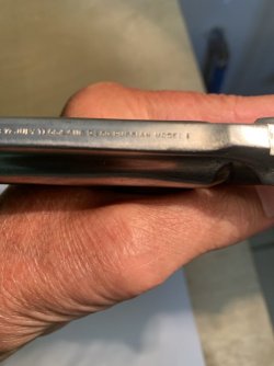

Looks like you have a 3rd Model Russian.
The little spring and cam next to it are what closes the barrel catch. The screw for the catch or latch needs to be removed, spring inserted 'between the ears' of the barrel. The cam is next, round end towards the spring. The ramped face of the cam should face up toward the top strap. The hard part is compressing the cam against the spring with the barrel latch and inserting the screw at the same time.
Once that is accomplished, the cylinder can be assembled back on the pivot post / quill. The fluted extractor rod must engage the sprocket-like extractor cam in the barrel hinge. This may need to be attempted several times to get the timing correct.
Once the cylinder is seated correctly, the flat 'L' piece is slid into a dovetail under the top strap (short leg holds the cylinder) and the knurled screw replaced in the notch on the barrel rib.

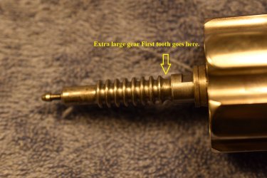

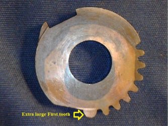

Hi There,
I will post the following about the extractor gear and extractor
rack. If you will notice, there is one tooth that is bigger than the
others (the first gear tooth). This extra large (double wide) gear
tooth goes in the first notch of the rack. See pics.
Cheers!
Webb

Mike, that did it! Thanks for your continued support, I now have a functioning SW no 3 in 44 Russian. My sincere thanks to everyone in this forum who took the time to assist me, you are appreciated. I think a set of ivory grips should complement this revolver quite nicely.
