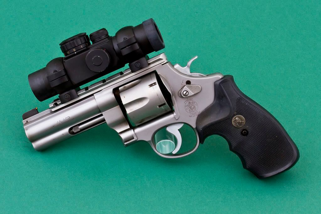

I agree with jcelect, I have a 1989 625-2 (5") that a gunsmith friend of mine drilled and tapped for a red dot and I've a Holosun on it. In order to get one that was drilled and tapped at the factory, you need to get at least a 625-4. The factory began drilling and tapping the 625s with that change in 93. Here's what mine looks like with the Holosun mounted. I used a Raptor base to mount it. If you prefer a a weaver type base, you can get one from Weigand.
If you prefer the weaver type base, here's what it looks like on my 629.
