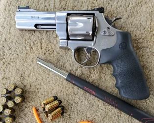

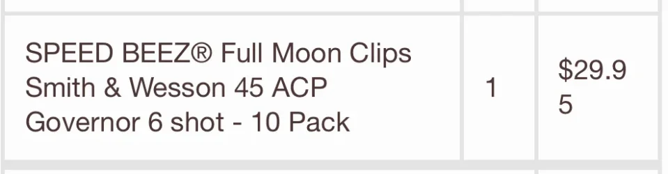

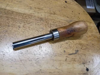

Hi there,
I use Speed Beez Moon clips in my 325 TR:
They come with a simple de-mooning tool.
Speed Beez also makes a good Kydex holster for the 325 TR, BTW.

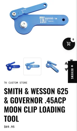

For moon clip loading, the best tool, IMO, is from TK Custom:
Not cheap, but worth it, IMO. They also have a better de-mooning tool than the free Speed Beez one.

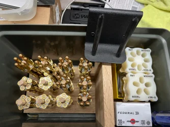

This reminds me: this guy on ebay 3D prints some nice “moon clip carriers”. You can put on your belt or remove the belt clip and put in your pocket. I have them for 325, 986 and 929, for 3 clips each. No connection other than being a happy user.
