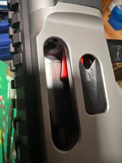

I’m selling mine if they ever give it back after warranty repair. 5 months and counting for a rifle I’ve never even fired. From the factory the follower left the tube mag and locked up the action.
