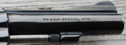

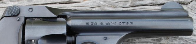

A more subtle reason S&W might not have been willing to retool any of its frames solely for the .454 might be that it couldn't say:
.454 S&W CTG
on the barrel!
The company seems to have a penchant for proprietary calibers. I could only attach five photos, but I think you'll see my point.
Just thinking out loud, here.
