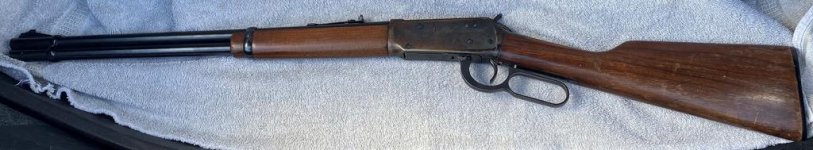

I have a 1967 model Canadian centennial that was a gift from my grandad. It's a wonderful shooter, the octagon barrel adds a nice weight to soak up recoil.
We are actually taking it out to the farm tomorrow morning. My oldest daughter has shooting with dad on her summer time bucket list. Coated bullets over unique make it shoot like a 22 rifle.
