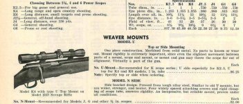

I was lucky to find a really nice Mod 63 last fall, about a 1946 vintage. The top of the receiver and the barrel has been drilled & tapped just two holes each (with filler screws) that appear to be factory. I am thinking this is to accommodate some kind of scope mount. Does anyone know what mount this might be and where (if) I could find one? Pictures attached.
I tried to show the 5" separation between the two sets of holes.

Echo made a number of strange mounts; that's why I initially thought of them. I did a bit of digging in Stroebel's book (Old Gunsights and Rifle Scopes) and came up with a more likely suspect - the Weaver Type "U" top mount. Here's a close-up from a late 40's advertisement:
