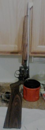

Although its not an X frame and it is legal because the barrel is over 16" I have fired this "revolver" in 45 colt many times with nothing but a decent shirt and have never been bothered in the least. Your arm isn't that close to the gap and it is well down and a bit under the bottom portion of frame. Good timing and fit goes a long way also.
Very cool but I would say that the cyl gap blast from even a hot 45 Colt is nothing compared to a 460 or 500.

While I agree that the gap blast on a 460/500 would be terrific right beside the gap, one built into a carbine with a fore stock would be ok with a canvas shirt. You don't hold you arm along side the gun, the crook of your elbow moves you arm in this area down under the frame and and considerably away from the gap. Mount any rifle in a normal hold and look where your left arm is. Yes, you could do something stupid and get hurt. But, you can do the same type of stupid putting your hand in the wrong place on a completely stock revolver. Just like any gun there are safety issues you need to address or you'll get hurt.
I only fire mine using a heavy shirt and glasses. Using a stock moves your face considerably closer to the gun than any type of normal hold and you can feel a slight bit on your face. Safety glasses should be part of your equipment in the first place.
