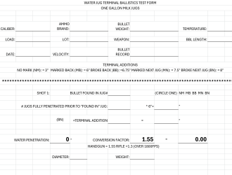

Chronograph even HST and Gold Dots if you can; minimally shoot them through some sweat shirt material into a couple water filled “milk jugs.” Catch them in a bag of rags. When a police trainer, I discovered each lot number of name brand ammunition left the barrel of 4-4.5 inch service pistols at velocities as much as 100 fps different from another batch and sometimes below advertised. And from a 3.1 inch barrel expect a lot less. The reduced velocity may fall below the expansion window for a given bullet’s design parameters. Reduced velocity also reduces the foot pounds of energy deposited in one’s target. Bottom line: you can’t assume giving $35 for 20 rounds of 9mm (or any caliber) guarantees advertised performance when “the chips are down.” Retired Detroit Homicide Sergeant Evan Marshall, the author of numerous books and treatises on stopping power, once said he was a lot happier before he bought his chronograph. Me too.

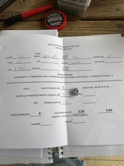

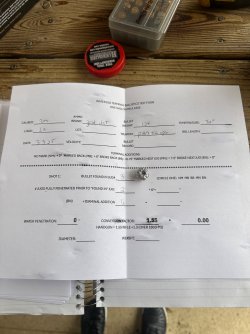

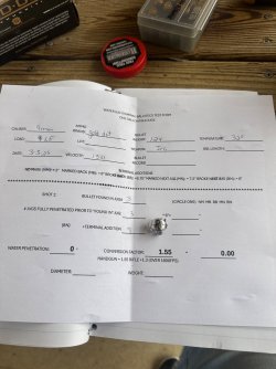

With all that info, I have another question: Can ballistic/bullet performance testing be done accurately with water jugs?
Not sure how all those images go together without further review….but, you can get my drift.
I am not the originator of this type of testing, I’m not claiming anything like that. The originator stated that there was tons of testing that went into it. I’d like to ask about your comparative data from your tests. Gold Dot, HST….so on. Do the numbers seem similar?
Thanks…
