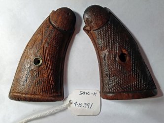

Is there a broad source that covers the evolution of grips for Hand Ejector revolvers? Preferably with photos?
I am wondering about several points that seem to conflict. I purchased a lot of grips from the estate of a long retired gunsmith. Several sets of early wood grips were included. The man had a habit of tagging grips with the serial number of the firearm they were taken from.
My larger questions are about the earlier "shorter" grips. What years are correct for the several finish/pattern designs we see? When did S&W stop producing the shorter grips in favor of the current design?
Then we apply this to the grips in the photos. He tags them as K frame. He also includes a serial number 410391 written on the grip and the tag. Based on what appears to be the serial date range, it looks like the pistol would have been produced after the transition to the taller grips. In fact, the grip pattern is essentially identical to the 2nd version of the .44 Hand Ejector grips from the 1920's.
These grips are correctly sized and shaped to fit a K, but it would seem they were originally intended for a pistol manufactured before the use of the lettered frame scheme.
I will be offering these for sale and I want to be absolutely certain of my descriptions. Please look and edumacate me.
Those are standard service stocks, K frame, from the 1920s. The right panel is well worn down and someone added some additional grooves.

Yours appear to be the K frame checkered diamond service stocks, non-medallion, 1919-1930.
They are well worn, chipped, and it looks like someone started to re-check them at some point. Missing an escutcheon and no screw. Value will be minimal imo.
