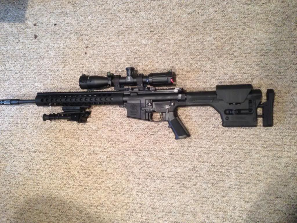

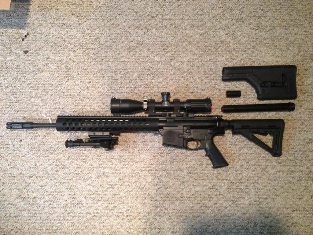

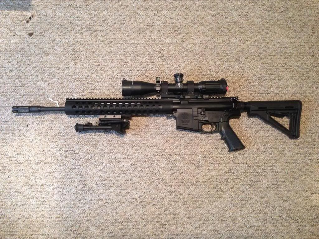

Picture of my rife before hand.

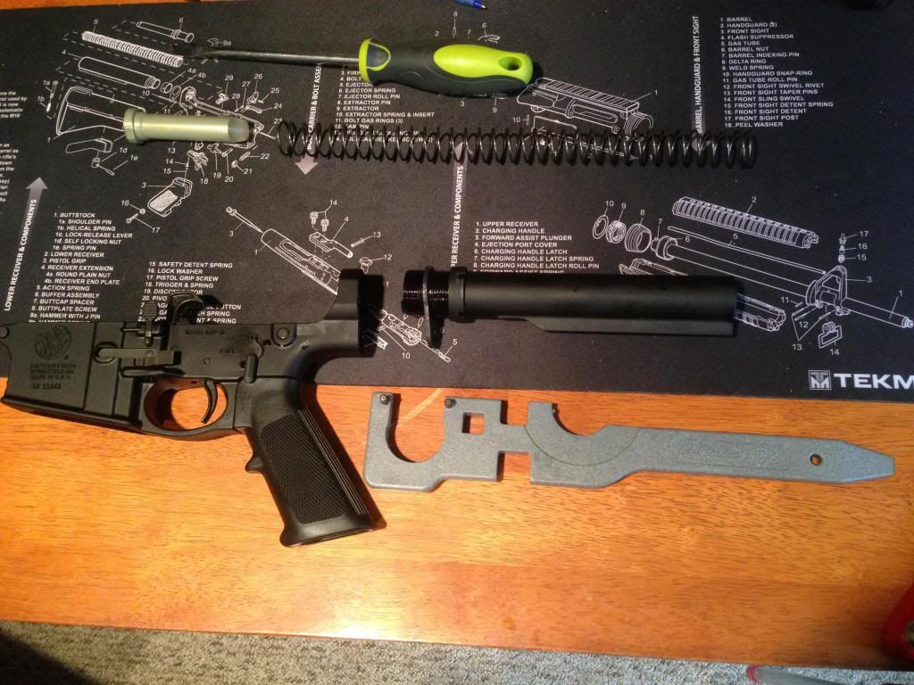

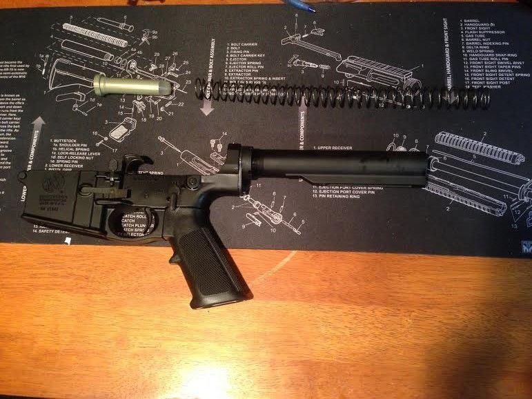

Laid out with the all the components
Removed the stock the spring and buffer
Remove the Buffer tube. This wasn't hard other than they stamped the castle nut from Factory.

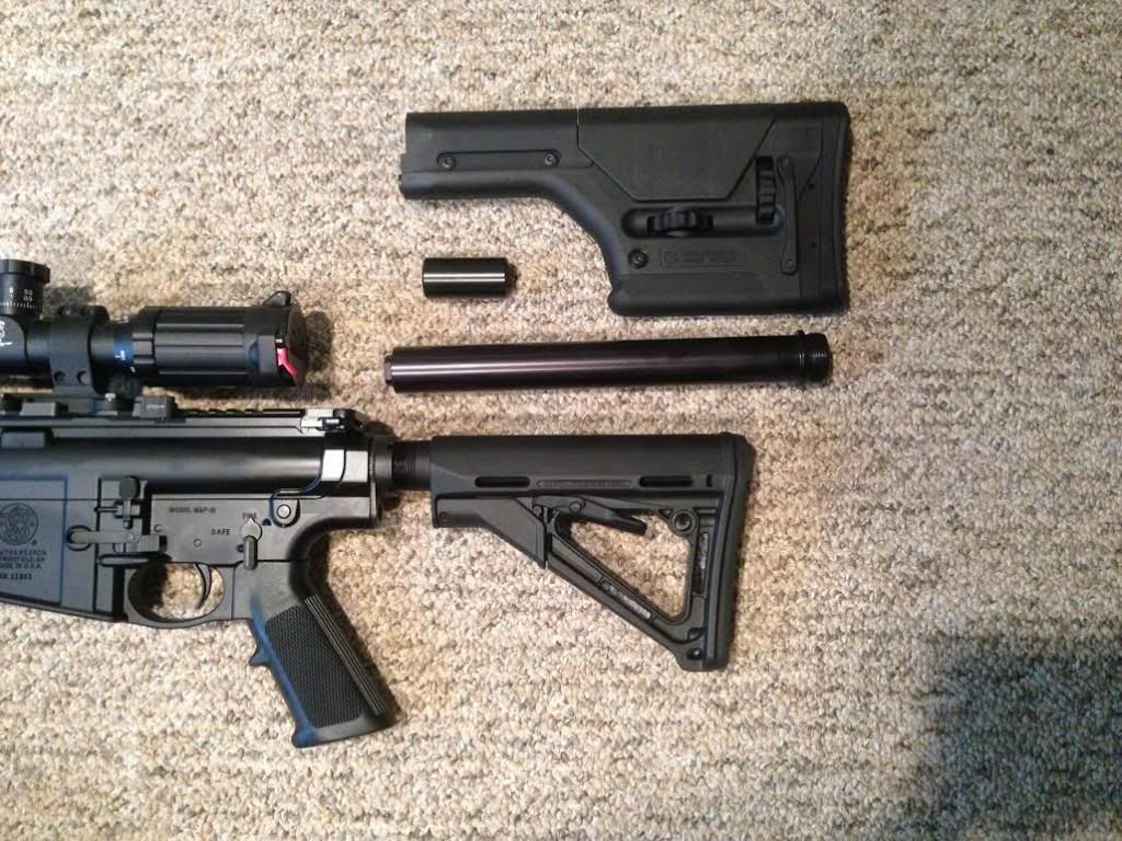

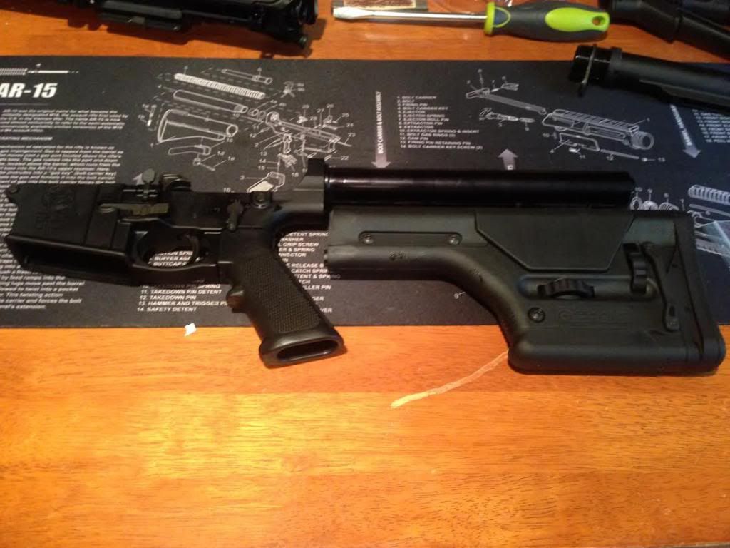

Install the A2 buffer tube. ( be careful when taking stock tube out the buffer retainer will jump out keep a hand on it so you do not lose it. Then besure to press it down with you install the new tube.

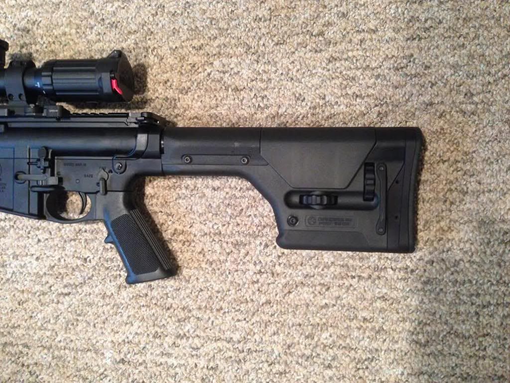

Putting the PRS on the tube was fairly easy just twisting sliding hitting. but went right into place.

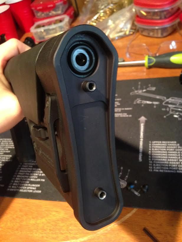

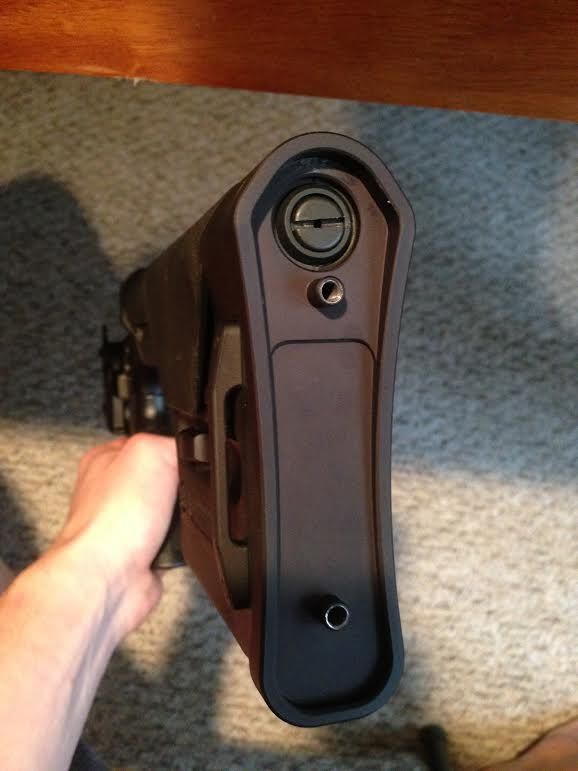

Remove the rear butt pad and see the exposed hole for the screw.

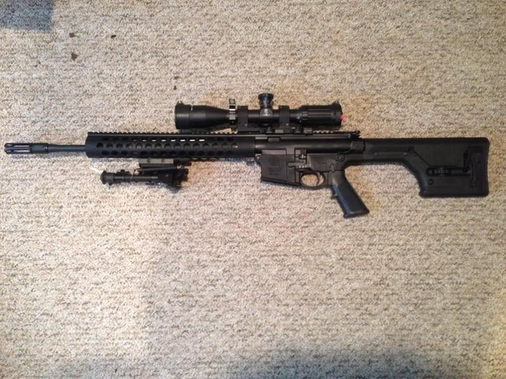

And thats it!!!!
