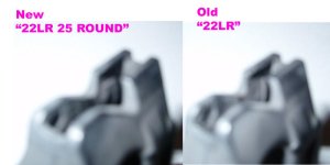

Hear ya go sorry it took so long,
When I took the pictures this time I kept the bullet as far back as it could go and where it would normally be when you would go to load the mag into the gun.
As you can clearly see the bullet is sitting at a higher angle with the new mag(22LR 22 round).
I took the mags apart and looked at the orange followers and they are exactly the same.
The only thing that would make this difference would then have to be the black housing of the mag. So I started the tear down of the mags and started looking around.

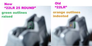

The pictures are not very god but it should be good enough to see that there is a difference in the top of the tracks where the bullet slides. I tried outlining the differences. The green outline shows a raised sections and the orange shows indented sections. The green outline is the track that the bullets follow when sliding up and down.
I guess we had the right idea months ago... it's just that my dremmel could only remove material... not add it. Thanks for the pics.
On Candyman"s pic, did anyone else notice the posible difference in the spring? Look at the spring where it goes around the follower and compare it to the ohter as you move down, one on the right looks spaced wider than the left.
