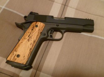

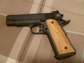

That's how my Wilson/Colt disassembles, it has a bull Barrel but it has a hole through the guide rod to insert a paper clip to hold it back while taking it apart. You can go either way, bushing or bushingless.
I have a two piece guide rod in my commander. Sounds like similar process with yours.
If you choose to try another type of guide rod check Evolution gun works or Wilson Combat.
There are videos on the internet on this. I made tools out of a paper clip that hold the spring compressed with the slide opened. then disassemble as usual. I know that I am not giving explanation, but it works. RIA Tactical II in .40. Bob

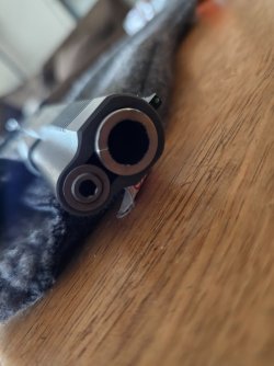

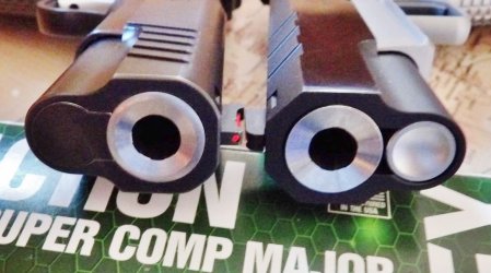

Lou, with the 2 piece guide rod, I used to do it as you describe. For some years now, I have used an EGW or 10-8 reverse closed end recoil spring plug, and regular GI type guide rod. So no special tools, trick guide rods, paper clips, etc. required. Just pull slide stop, remove slide assy., GI guide rod, recoil spring, plug and barrel. Reassemble in reverse order..

That's it ! Nice 9mm's and bushingless.
Would you recommend going your route? Putting caps and a GI rod?
Would it make assembly easier??
Those are cool setups.
Although I have a couple bull barrel 1911, all my others have bushings and GÌ guide rods, not those silly FL jokers. 😀
Closed end reverse plug for a standard guide rod, I was unaware of these things! If I ever get a 1911 that uses a bull barrel, I'll have to remember this.
