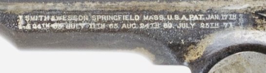

See photos of Schofield patent drawings. I have a few more. Gotta look through my Schofield stuff.
The other patent dates are seen in the barrel photo's.

Barrel photo
Here is another late serial number barrel photo that clearly shows applicable patents. The later patents were actually never applied since the gun was discontinued about 1879ish.
