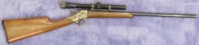

Would it be difficult to ream the chamber on a falling block rifle from 44 Special to 44 Mag?
I'm thinking the best way to re-ream the chamber to 44 Mag would be to pull the barrel from the action! Some people would want to try from the breech with the barrel still on the gun. (If the gun is already a good shooter, I recommend not messing with sucess. I have seen too many good shooters "Improved" and the change in harmonics destroyed the accuracy!) Your gun, your choice, your responsibility.
Have you tried any of the Elmer Keith hot 44 Special loads in the rifle? You may find what you wish with an ammo upgrade. (Some of these are loaded by Buffalo Bore.)
Ivan
