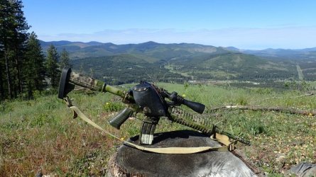

My ranch rifle is simple homebrew PSA midlength upper/PSA lower, 1/8 twist bbl with a 4.5 lb LaRue MBT trigger and topped with an old Burris Fullfield 3-9 scope w/ German 4A reticle. I shoot varmints for coyote bait in the hundreds/thousands and while the shots are not usually over 100 meters a 3-4 MOA rifle won't cut it, tho MOA accuracy isn't needed, either.
Load is bulk Hornady 55 grain SP over 25 grains of 4895.
Groups below left to right give an idea of the level of accuracy it produces. All groups shot from same sitting position, elbows rested on knees as shown (we rarely shoot from the bench). The gun got smacked the other day and I rezeroed it.
50 meters/54 yard. 200 meters/219 yards final zero (4.5 inches center-to-center). 200 meters/219 yards (3.5 inches center-to-center).
I've an ArmaLite M15 National Match with a free-floated bbl that is a true MOA shooter but it's heavy. The PSA gets used constantly all year. Not as accurate, but definitely not inaccurate, either.
