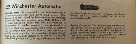

Here's a photo I found online of a close up of the cartridge… you can see a slight impression/crimp mid center. The '03 was the first and last rifle ever made that accepted this cartridge. The '03 evolved into the model 63 and sales skyrocketed.
I found some interesting info on the model '03 while searching this round. There are quite a few websites to read.
The Model 1903 rifle was one of the earliest semiauto rifles, and it would clog up easily if used with black powder cartridges. So Winchester chambered it for a new cartridge which was loaded only with smokeless powder.

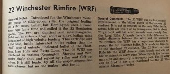

The .22 Winchester Automatic and .22 WRF are two distinctly different cartridges! the WRF is still in limited production. there were quite a few different firearms chambered for it.
There is a third odd ball .22 cartridge, the .22 Remington Special, which also had a very limited number of firearm models chambered for it.
The 22 Remington Special was just the Remington version of the 22 WRF cartridge. Many companies in the old days seemed to have a hang up about using a competitors name and would rename a cartridge if they offered it in one of their guns.

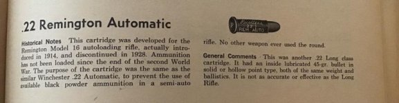

The real oddball was the 22 Remington Automatic cartridge. It was made for the Remington Model 16 rifle, intended to compete with the Winchester 1903. Not interchangeable with the Winchester loading and never chambered in any other firearm it wasn't particularly successful. Ammo has long been out of production and even ratty boxes can bring good money, especially if the shells are in good shape.
Nice find! The Winchester 1903 was the first successful auto-loading .22 rimfire rifle. .22 LR ammo was loaded to different power levels at the time. Some was black powder, some was semi-smokeless and some was smokeless.
In order to guarantee reliable functioning, Winchester developed the .22 Winchester Auto cartridge specifically for the gun. It was loaded with smokeless powder and the case was fatter above the rim than a .22 LR. Modern .22 LR cartridges will fire in a Winchester 1903, but it's a bad idea. Cases will usually split, accuracy is poor and functioning is unreliable.
