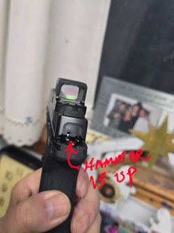

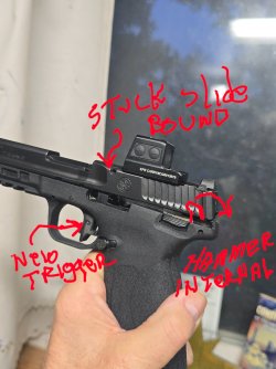

Hey team,
I got myself in a trouble. I was putting in a new moray short stroke trigger on the M&P 22 WMR.
During reassembly of the slide I missed the reat slide alignment to the rail, accidentally pulling the trigger. So the hammer is up position and my slide is bound by misalignment.
I need to somehow return the hammer down to release the slide forward.
Any ideas?

Hey M&P team, I fixed it by using a small screwdriver through the back side, got it wiggled between the slide and the hammer, then held it down and let the slide back.- success.
