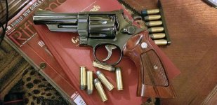

Here is my 25-5. I have not shot it lately but as I recollect it shot fine for me. I'll look up the SN to see when it was made. Triple alpha AJJ = 1985 (SCSW)
