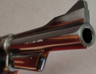

Has anyone ever seen a taper like this on a 27 or a 28 barrel??
Not quite a bull barrel, but close..
I have not seen a taper that was that subtle before.
I'm wondering if it was an option or if it's just the way it came out the factory on this one?
I don't think the barrel has been shortened, either as it seems to fit into the 5 inch case just right.
Unless that ejector rod looks a little shorter than normal?
Thanks

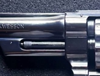

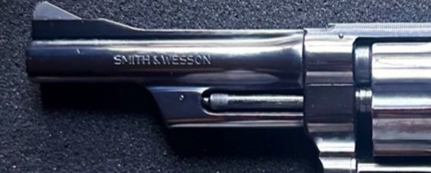

Hmmmmm... the barrel pin appears to sit proud of the frame surface on the left side, but at or maybe below the surface on the right side. I'd measure the with calipers, I'm thinking the barrel might have had an issue with the forcing cone and was turned back and the shank and forcing cone recut, giving the barrel a short, tapered section where it meets the frame.
I thought so, but the pic of the gun in the case shows the muzzle is tight in the insert. If it was shortened the barrel would be shorter.
Im not seeing anything abnormal with the barrel itself but agree the barrel set pin in the frame looks mushroomed on the left side and shallow on the right side, both are signs the barrel was likely removed but its hard to tell from the pics could just be the lighting.
On a side note do you know the serial number or how early a dash 2 it is?
There are very subtle hints the barrel might be a little bit older than the frame.
I agree that it looks like the back shoulder of the barrel was turned down so that it threaded farther into the frame so it could have a new forcing cone. I have done this on eroded forcing cones and large gaps. No need to touch the muzzle. I trimmed 4 turns off the shoulder of a 4" model 53 so it would have enough shank to work in a model 18 That made the barrel .125 shorter. I also has to shorten the ejector rod.

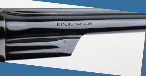

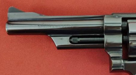

I don't think that explanation is accurate., Here's a pretty good pic of what a 27-2 5" should look like (top photo)
The photo at the bottom is a 27-2 8 3/8
