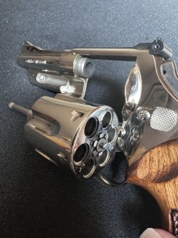

It was not.Based on what I see, it was not nickel originally. Nickel guns from factory had a N stamp on the back of the cylinder and on the frame. Regardless, it is a neat looking piece. Enjoy shooting it! Bob

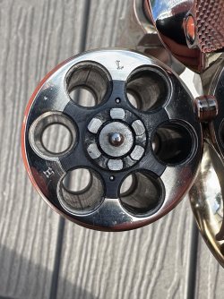

I will check it all and get back to you.I see an "L" on the cylinder. Nice early -2. Is the other an "H"? Highway Patrolman finish.

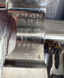

Are there rework stamps on the left side of grip frame? Barrel's not serialized.
It’s a beauty.Refinished or not, I'd be proud to own that.

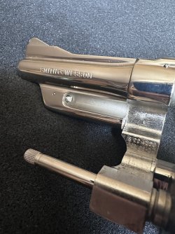

The change to left hand threads.I will check it all and get back to you.
What does the L indicate?
It is a three screw.A factory change of finish to nickel would normally be stamped R-N inside of a rectangle. In addition, it is my understanding S&W did not offer a change of finish for the Model 28, Highway Patrolman. Per Roy Jinks' book, the change to the 3-screw frame for N-frame revolvers took place at S227149. Is your Model 28 a 3-screw or a 4-screw?

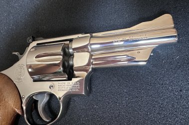

I will find a set of Diamonds for itVery nice early 28-2, the nickel makes it more interesting even if it began life blue IMO.
Ive also seen early 19-2 cylinders with the "L" stamp which dissapears fairly early and was no doubt to distinguish the new left hand threaded ejector.
The channel cut behind the ejector rod end knurling was the way they identified the new L hand thread ones from the older ones in case parts got comingled.

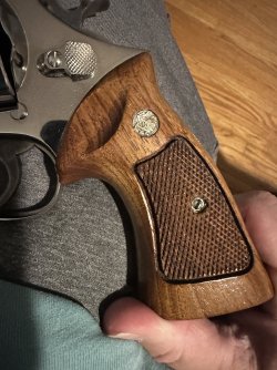

Ps, Your gun is a bit early for non diamonds IMO but a nice set of smooth presentation Magnas with deep escutcheons woukd really make that one "Pop".
I don’t know what these numbers refer to.A factory change of finish to nickel would normally be stamped R-N inside of a rectangle. In addition, it is my understanding S&W did not offer a change of finish for the Model 28, Highway Patrolman. Per Roy Jinks' book, the change to the 3-screw frame for N-frame revolvers took place at S227149. Is your Model 28 a 3-screw or a 4-screw?
