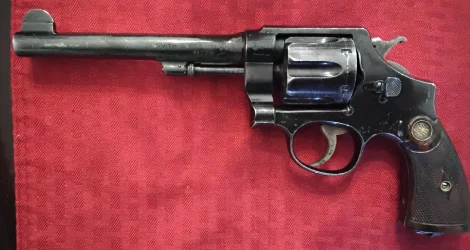

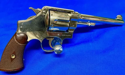

Very happy was able to pick up this 2nd model recently. It left the factory in June 1929. The grips are numbered but not to this gun, about 800 numbers distant. The only makings have found is 1054 stamped on the grip. Obviously back to the factory but not certain what was done. The previous owner has no knowledge either. Looking at the view of the left side you can just about make out the head of a screw. Possibly there for a grip adapter. Any and all comment's appreciated…..Lou
Outstanding acquisition.
It's a beauty. I find something very interesting. It went back to the mother ship in 1954. Every pre war gun refinished after the war at the factory I've ever seen leaves one little piece of evidence: a polished flat rebound slide retention pin on the left side of the frame in front of the top of the grip panel.
Pre war new guns and factory pre war refinished guns have a domed, not polished flat. New production post war polishing protocol has flat polished pins. Pre war guns factory refinished after WWII also have the pins flat finished.
Yours is domed. And you didn't report a refinished stamp on the heel of the grip frame, left side. Does it have a stamp something like this?
The only stamp seen thus far is the 1054 stamp.
Could it have gone back to the factory in 1954 for work that did not include a polish and re-blue?
No way to know unless the Historical Foundation has service records they can pull up to see what was requested and done. They need a Letter of Authenticity first then they will do a deep dive.

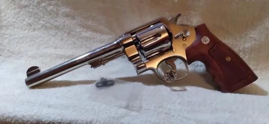

My 44 HE 2nd model lettered to 9/13/1923. Serial 20943, with an armory proofed WWI frame, repurposed for this civilian gun, and factory nickeled. These 2nd model big bores are wonderful shooters.
The minimalist factory grips are stored away, don't want to damage them. Grabbed these Altamont's with finger grooves from eBay and they work well for me.

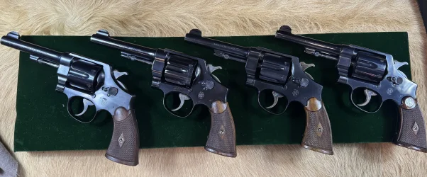

Here’s a few…
The 3 on left are .44-40 from same shipment. One of the stocks is numbered the others being correct style (thanks .22 Highpower) that I had to find. The one .44 spl on right the stocks do number. The 44-40’s are 36161, 36162 & 36168. The .44 spl is 45444.
I know another forum member or 2 have .44-40’s from this same batch.
Here’s a few…
We could search a long time and not find three in 44-40. Beautiful and rare 2nd Models!

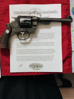

I should letter my 2nd Model Target. I’ve had it a long time now, shoot it pretty regularly. It wears some non matching prewar Magnas that I consider a good upgrade. It doesn’t even have the hole in the crane for the cylinder hold open detent. It’s number 40328.
Does page two mentioned what stocks were on it when it left the factory? I thought the Magna stocks were introduced in 1935 with the 357 S&W Magnum.
Kevin
The letter does not state what stocks were on it when it shipped. I thought it would have.

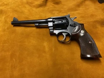

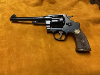

I managed to get my hands on two 2nd Model H.E.s in 44 special, one was modified by the factory with later target sights installed and a complete refinish all in the same year, once to test the results the second time for the refinish. The other is as issued.
