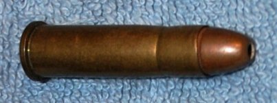

THERE IS NO "MODERN .32-20 AMMUNITION" FOR RIFLES ONLY!!!!!!!
.32-20 was and is a rifle cartridge, since it's introduction for the Winchester model 1873 in the 1870s. However it was first adopted for revolver use by Colt in 1882. ALL CURRENTLY MANUFACTURED .32-20 ammunition is safe for use in any revolver in good mechanical condition. Any commercial ammunition of any period with flat-point bullets, whether Lead or jacketed, is appropriate for revolvers.
There was at one time a single load specified for RIFLE USE ONLY, and that was an 80 grain load with a jacketed round nose hollow-point bullet that looks like this one below. As Art Doc pointed out, this type ammunition has not been manufactured for decades. I have seen dates from the 1960s clear back to pre-WWII for the end of production for it. The head stamp usually would be H-V, Super Speed, or something similar to indicate it was for 1892 and similar rifles, it was not for model 1873 Winchester rifles.

Just a quick note there is one 32/20 “high speed” brand advertised on the web under Ventura brand .They advertise a current manufacture rifle only I think with an 85 grain jacketed bullet .Thats why I feel it is good to not say there is no modern manufactured rifle only ammo for this caliber you never know when someone new might run across this on say the Ventura website and accidentally order a box .Anyway OP enjoy your firearm and heck let us know how it shoots and how you like the caliber .
The original HV .32-20 load used an 80 (or 85, I don't remember) grain full jacketed hollow point bullet and was cataloged until the early 1960s. There were also similar HV rifle-only loads made in .38-40 and .44-40 prior to WWII using lighter than standard bullets. In any event, the HV .32-20, .38-40, and .44-40 cartridges are distinctive in appearance, not easily mistaken for standard loads.
I don't know anything about Ventura's HV offering.
