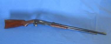

The John Pedersen designed Model 25 Remington makes a nice walking around rifle and a good companion to the 1925 vintage S&W revolver.
