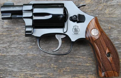

My 36-11 classic is going back for repair. The side plate is... recessed into the frame around the yoke screw. The ejector has way too much play and will hang onto the cylinder sometimes when springing back into position. The hammer will sometimes catch onto the double action sear when firing in single action (partial hammer fall). Oh and the cylinder gap looks a bit wide, too.
This will be the 3rd new S&W I've had to send back for repair this year.

I sent it in the first time and they did absolutely nothing. I sent it back again and they kinda did a half assed job. They reformed the side plate and frame where they weren't flush to force them to be flush, which I find incredibly odd. It looks weird up close in the light. Of course this required them to refinish the frame but they did a partial refinish so some areas of the frame have a different polish underneath the blue. The ejector play issues was repaired by replacing the ejector, ejector rod, and cylinder. Since the star is different the lock up is different now. The lock up is now a little loose but more consistent whereas before it was tight one some chambers and a little loose on others. The new cylinder has spotting in the blueing and kinda looks like crap. The cylinder gap is the same as before measuring at .010". There is a new scratch on the barrel and a new scratch on the frame. The front edge of the frame, forward of the trigger guard, is now also a bit scuffed up. The hammer snagging issues in single action is still reproducible. Over all the repair feels a bit half assed.
