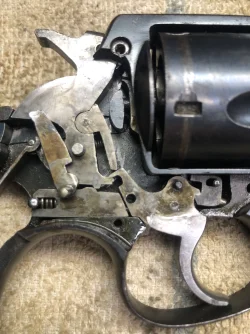

I thought I got a great online deal on a .38 Regulation Police. After receiving it, I noticed some "issues" with it. I'm more of a K-frame guy, knowing my way around the inner-workings of them. I noticed this little I-frame's cylinder didn't always rotate, and the action was pretty tight. I disassembled it for a good cleaning.
This is a photo I took just after removing sideplate and before any further disassembly.IMG_3152.webp I cleaned it up good, and noticed some things didn't seem quite right. I've since learned that this is some kind of Asian or South-American copy of the real deal. That explains a lot. Still, I'd like to make it work a little better and at least fire it.
On disassembly, I noticed the hand does not have the usual (like K-frames) method of applying forward pressure to stay in contact with the cylinder. It has a round pin that simply slides into a hole in the trigger. There is no spring, like on K-frames, that applies forward pressure to the hand. You can see in these photos the hand installed into the trigger, and then flipped over showing you the backside.IMG_3190.webp IMG_3189 (1).webpThinking I was just overlooking something and a cleaning would resolve it, I cleaned everything up, reassembled, and the issue has not been resolved. The hand will usually rotate the cylinder enough to lock for one trigger pull. After that, it might rotate, and might not. I have an investigative, tinkering mind, and as this revolver sits now I cannot see any method to ensure consistent contact between the hand and cylinder. I can hold it muzzle down and it will usually rotate. Hold it muzzle up, and no rotation. I'm thinking something has to be missing. I see the notch near the bottom of the hand, and think it has to be there for a reason.

Could there be a spring on the sideplate (maybe missing?) to hold the hand forward? We can't see what the inside of the sideplate looks like.
I should post a photo of the inside of the sideplate. There is no place for a spring. It's just a milled slot with a pin protuding into it that holds the hammer block (which is broken).

I have an older Smith, not quite sure of the model as it's out of state. The spring for the hand is in the sideplate - horizontal spring & plunger. Was a major PITA to get back together. The plunger always was too far forward to seat behind the hand.
Regulation police hand and sideplate with spring loaded plunger…plunger is pointing down in the picView attachment 787736
That is exactly what I needed. Mine had a pin there, but it was driven in. No spring behind it and it didn't move. I had to drive it out. Thank you!
