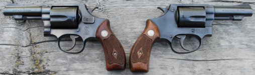

My photo shows the difference in the Baby and the next model.
You've got a pair of dandies there. Enjoy.

Good looking gun thanks for posting and you have two. Wow 1 for each hand .Have you shot them ? Let us know how they handle and shoot . I would have to do the gun in each hand thing at least once of course with no one looking lol.
Nice grips Oldster. A friend has the 2 Baby Chiefs I inquired about. We do plan on a range outing. Thank you for the reply, this is a great place for info and all you folks are so considerate in your help.

Those indeed should both be Baby Chief Specials.
The one in your pic, is the higher or lower S/N? It looks like a serrated ramp FS. The lower S/N might be a smooth ramp FS. That is in excellent condition. The smooth ramp FS variation was only made a very short while. Since all the Baby Chiefs are fairly scarce, the variations on them (half moon and smooth ramp FS) are even scarcer.

Hope the picture comes through.
The pic is fine.
This Baby Chief has the first style flat latch (of three styles). These are common on the Baby Chief, but they were not the first type of thumb piece used on this model. The first style was sculpted, just like the type used in the post-1966 period. It was quickly dropped on the CS, in favor of the flat latch seen on your gun. Later, on the "full size" Chiefs Special, the first style flat latch was replaced by the second style (sometime in the mid-1950s) and then, later in the 1950s, with the third style, which lasted until the sculpted type returned in 1966.

I'm betting the one in the photo is 14517.
On another thread Hondo44 said the lowest sn he's seen with a serrated ramp front site is 6541. I'd put my money on 6029 having a smooth ramp, which makes it very special indeed that dutch harbor john nabbed one of each.
My data base has lots of holes, but it shows 11920 (shipped September '52) as the highest sn with a smooth ramp.

Not very good shots but hope you can see the differences. The newer chief has the wood grips with a gold S&W medallion. The older one has black plastic grips with the S&W logo carved in it. The front ramp sight is serrated on 14517 and smooth on 6029. I like the thicker sight on 14517. Now if the rain would let up I want to see how they shoot.

Those are beauties!
I've not seen or heard of the black rubber grips on a Baby. Does the serial number on the inside of the right grip match the serial number on the Baby's butt? I believe that would be quite a revelation if it does.
Those are beauties!
"My sediments exactly!" I've never heard of a Baby with (original) grips in black hard rubber (which is what the factory used.) If they are actually black plastic, I'm guessing they are post-factory additions. Does this matter? Only a little to the purists... those are still two very cool revolvers. :cool:
