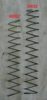

FYI. Tandemkross has a new mag spring for the SW22 Victory that is nearly identical to the 380EZ spring with the added benefit of having 1.5 additional coils. They're so close in size that a TK spring cut down to the exact number of coils as the EZ spring weighs only 1 grain more. Yes I sacrificed one as the pack had three and I only needed two.
These increase tension about one pound on a fully loaded EZ mag and about 10-12 ounces with only one round in.
The only issue I had was a bit of binding when loading the last round in one of the mags. Turned out to be a twist in the spring which caused the last few coils to catch/bind on the bottom of the follower. I increased the chamfer on the bottom inside edge of the follower to correct that and now they're perfect.
Fired 150 rounds total through both mags, while intentionally limp-wristing, and they were 100% reliable. This was with only 2 rounds at a time in the mags so each one had more than 35 chances to fail and didn't. Since I only had one original mag that would stovepipe a last round occasionally (once every 6 to 8 mags), It'd probably be a better test for someone with several problematic mags.

Well it looks like my success with the Tandemkross springs was short lived. Went to the range on Friday, third trip with the new springs, and had 2 last live round stovepipes out of 70 rounds fired. Both were with the same mag that was doing it initially. Checked the spring tension again and it has changed only a few ounces since new.
I did manage to tighten up the groups going from .356" to a .357" sized bullet but it still continues to print 2"-3" left @10 yards even after moving the rear sight .040" right of center.
Scuff up the top of your follower (to increase friction) where it makes contact with the shell casing and you'll see an improvement in the last round stovepipe issue.

This worked for me. Thank you very much for posting this. 1,100 rounds without a single last-round-stovepipe failure since installing these springs in my magazines. If they start failing again as the springs wear, then I'll add in the sandpaper/scuffed follower modification.
The only remaining malfunction I have is that sometimes the top cartridge in the magazine pops up out of place when reloading with the slide open. It doesn't completely exit the magazine, but ends up sticking up at an angle with only the back of the case still held in place; of course it gets caught in the slide if you try to load it.
I think this happens because the feed lips on the magazine are so thin and short. I've considered trying to tune the feed lips downward a bit with a pair of pliers, but I'm hesitant to mess with that since it's not something I could just undo (like the springs).
For now, I'm just trying to train myself to load the magazine with a slow but firm press-hard-til-it-clicks so that the top cartridge doesn't jump up out of place. Seems to be working great so far. No failures in 400 rounds (which was more than 50 reloads because I didn't completely fill the mags each time). It's a just a bit slower, and I also have to train myself to do two different types of reloads since it still requires a *lot* of force to seat the mag if the slide is closed instead of open.
