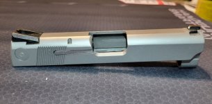

Well sometime u don't know what u bought. Went to install rear sight in the 6906 slide and the site wouldn't fit. Guessing this is a pre-novak slide?? Is it as simple as milling off behind the sight so the novak fits? Is the dovetail the same angle and depth?
Thanks,
Rosewood
I tell you, having the bead blast cabinet setup with the special sauce makes working on these stainless 3rd Gen Smiths a breeze. Once you make the changes, you blast it and voila, it looks factory. That slide was semi-polished when I received it. Now it looks like a brand new slide.
Rosewood
