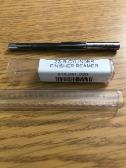

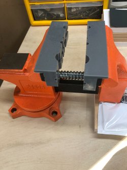

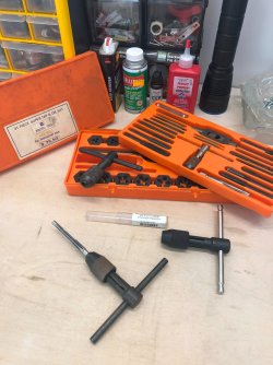

There are many, many Members here who have had the problem of S&W 22's with sticky chambers. I have a Manson reamer program running right now with two (2) correct Manson reamers, tap handles, and instruction sheet all for free. This is a loaner program whereby I send it to you via USPS Small Box Priority Mail and when you are finished you send it back to me same way. Read all about it in the "Smithing" sub forum...look for Manson reamer loaner program, and then add your screen name to the list in the post titled "Memorial day update loaner program" and I'll contact you when it is your turn and I'm sending it to you. At the rate we are going it should be within a few more weeks.
All the Members who have used this reamer have reported new ammo drop in, drop out fired cases when gun is inverted....just the way it should be. The blame seems to be on worn reamers used by S&W during factory manufacturing which is why some have some not. In any event the reamer will NOT enlarge your chambers, it will simply bring them up to SAAMI 22LR Sporting dimensions and they will now handle all ammo without any adverse effect on accuracy. All you need is a shop vise, and some cutting fluid as I can't send liquids through the mail. Tap Magic is cheap and available.
Sign on..get the reamer, do the job (takes maybe an hour tops)....you will be very happy you did!
