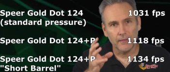

Thank you very much Chief, and ditto what Goldstar wrote. I bought the Speer non-short barrel 124g +p, as it was readily available, and works well in short barrels. The Ammo Quest 3" barrel chrono results were close enough to yours to validate them for me.
