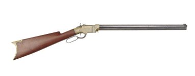

Roy Jinks History of Smith & Wesson has a diagram of the Volcanic round. It was used in both the Volcanic pistol and rifle. The Smith & Wesson Volcanic lever action rifles were .50 and .41 calibers. The pistols were made in .31 and .41 caliber.
One can only imagine what Smith & Wesson would have become if they had not sold their Volcanic Rifle patents to Oliver Winchester. Here is a .41 Volcanic Smith & Wesson rifle. What a beautiful rifle and made in the 1850s!

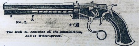

In case you haven't seen one of these before.
A fascinating early step in cartridge development though not a particularly successful one. A step along the road to a couple more fruitful designs in both guns and ammunition. I had 4 of these at one time, acquired when I bought an entire ammo collection to get the few items I wanted for my own collecting interests. They were mismarked as "minie balls". Eventually sold them off at one of the collector club shows as my primary collector interest is rim fire designs. Cool item to see though!
An interesting video from Rock Island Auctions with lots of details about Volcanic No.2 ammunition for those interested. The box below was sold for $43,000 in 2020.
[ame]https://www.youtube.com/watch?v=l7J5IvMCrnw[/ame]
watch
