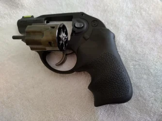

Just picked her up. Barrel on straight, all cylinder throats sized properly, forcing cone looks good, no end-shake, b-c gap looks right and the trigger is good to go as-is. Not bad at all for $467 otd.
Nice LCR. Love the fiber front sight!
You got it for a good price.
