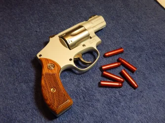

Just bought a new 432-3 I'm excited about. However, I've found a lot of reports around the internet about people experiencing light primer strikes. If I do, what's the best course of action? Have a longer firing pin installed? If so which one?
It's completely hit or miss. My buddy's 632UC hasn't had a single issue w/ light primer strikes while plenty of other have.

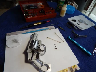

Data I have states minimum FP length should be .495" and optimum length is .505". My UCR 632 firing pin measured just under .490" with a pointy profile. FP protrusion from the frame bushing area was minimal at best.
My 632 UCR's fired cases exhibited weak, shallow, pointy indents.
I ordered up both the Apex and Power Custom Extended Firing Pins as I wanted to compare before install. The Apex FP measured .509" and came with a reduced power FP return spring. The Power Custom Pin measures .505" and uses the S&W FP return spring. Both had nice rounded ends.
I tore down the gun and installed the Power Custom. Kept the S&W springs. Firing pin protrusion from the frame is much improved. Did the work Friday. Been 10 degrees and snow since. I'll post up range results and primer pic.
