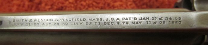

I picked up this 4" .44 DA First Model at a pawn shop a little over three years ago. .44 Russian, 1 7/16" long cylinder, sn 124XX, matching numbers on butt, cylinder and latch. Grips not numbered. I posted info about it online and was told to only fire blackpowder in it. I thought it was this forum but I can't find the post so it must have been some other forum. I've been loading blackpowder .44 Russian ammo for it but it would be much easier to load smokeless so I'm asking the experts on here, is it safe to shoot smokeless loads in this one?

I did a good bit of research on shooting smokeless in my near mint factory re-furbished .44 D.A. I came up with a load that works to my satisfaction: 200Gr. RNFP, 3.7Gr. Tight Group, 1.255 OAL, using a WLP primer. The recoil appears to be less than a black powder load of 18Gr. of Old Eyensford 3F, certainly cleans up easier. I still like shooting black powder, it just feels right.
I did not mention that I shot a box of Black Hills Cowboy ammunition through mine before deciding to make my own. The Black Hills stuff worked fine, it seemed a little stout.
When I fired the first black powder rounds the piece got a little stiff to operate after a couple dozen rounds. I found that the black powder residue was building up enough to cause the cylinder to slightly bind. I attributed this to the fact that it had been completely refurbished and was very tight, all I needed to do was wipe off the face of the cylinder and I carry a nylon brush in the box now to brush off the area above the cylinder and around the forcing cone. I do not plan on pouring boxes of ammunition through this old piece, just wanted to see what it was capable of doing. I am flat positive they were deadly at close range and provided an individual with more than adequate personal protection in a rather small package.
I have a nice refinished DA .44. No collector value so I shoot it in NCOWS matches. In 2018 I won my class in a match in Texas using American Pioneer Power black powder substitute.
I plan us shoot it again in the NCOWS National Match this year. (If the pandemic doesn't force cancellation.)
It is fun to shoot. However I find the .44-40 version a bit too stout.
