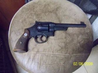

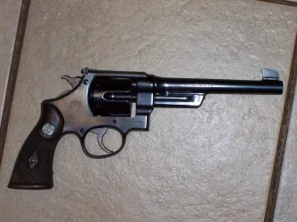

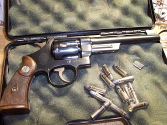

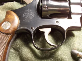

Not refinished as far as I know and I have had it since 1990. The side plate is tight and I've had it off several times over the years. The logo is normal possibly a little lighter than later guns, it was made in 1938. The side plate bluing is the same as the cylinder and barrel.
My old camera does not take very good pictures and the lighting is just the kitchen overhead LED tube's and the camera's flash. This picture is a little better but you still can't see the logo.
bpd: Unfortunately, with the washed out roll mark and the rounded side plate edges/seems, I believe your Outdoorsman has been refinished and the front sight blade has been replaced. Still a very fun gun!

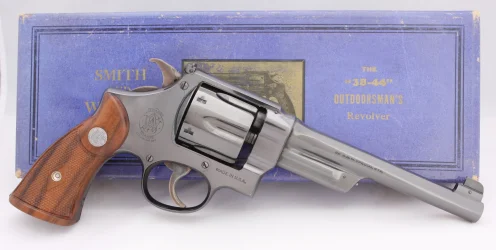

Compare it against this one that has not been refinished...

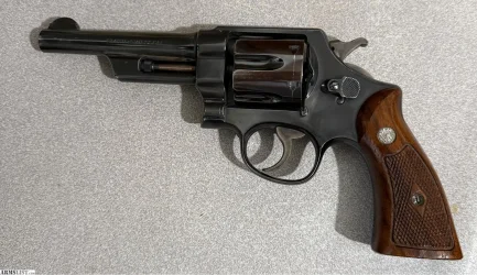

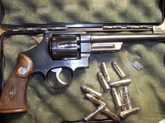

This is the Heavy Duty I’m talking about. The cylinder just doesn’t look like the rest of it. IMG_1416.webp
This is the Heavy Duty I’m talking about. The cylinder just doesn’t look like the rest of it. View attachment 892196
A picture of the right side showing the side plate seam and trade mark might be more helpful, but wear and finish does not appear consistent throughout…..ejector rod appears almost bright and the cylinder shows more high edge wear than the frame. Also, of course, the grips are post war replacements. Suggest you pass on this one.
The thing about most reblues is that unless the factory did it most places do not get the sideplate seam right, right at the lowest front screw hole. Not sure if they are sanding on it off the gun and rolling the edge some or if the new bluing is thicker and creates a rolled looking edge. That area is my very first spot I examine a picture or gun in hand of a uncertain finish.
The sideplate looks good I can barely see the line. And no dishing around the screws and the slots are perfect. Some speckles of rust on the trigger on that side. I did gunsmithing for many years and hot blueing as well as rust and Belgian bluing. I had to play detective with some guns. People don’t like to tell you the dumb things they have done to their guns. They take them apart and put them back together wrong and have no idea how it got that way. I always kept my mouth shut but would think “ Yeah, probably some gremlin got at it” I think if that cylinder is matching that it got damaged and reblued in some manner that caused that plum color. Hot bluing one part of a gun can cause that if the temp is not right. Cold blue usually turns a muddy brown after awhile. Another possibility is the cylinder was removed to “Make it safe” and stored somewhere else to cause that patina which is actually oxidation of the finish. It’s not worth what he’s asking for it. If I could get it for $700 I might check it out? Problem is we’re in the same state but 6 or 7 hours away. Thank you all for your input.

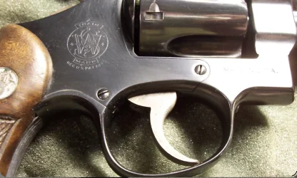

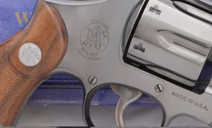

As I've said before my little camera doesn't take very good pictures. The side plate does not have rounded edges and the roll marks are all crisp, not washed out. The S&W emblem is lightly stamped just like my other revolvers of that era. I had a friend take some pictures of the area in question with better lighting. What ya think, refinished or not. I say not.
I say both revolvers in this thread have been refinished. The last one better done. than the one in the OPs question.
Sometimes guns, especially cop guns, were “dunked”, that is just disassembled and dropped into the blue tank with no prep work when going in for another small repair or maintenance. Many gun shops and armorer sheets listed this as standard or a low cost option. In these cases the markings may be crisp and the sideplate tight but often the color will be off.
On the Outdoorsman it appears to have been block polished by hand and pretty well done at that. But the sideplate isn’t the nearly invisible fit from the factory and very small polishing marks and directional changes are visible.
