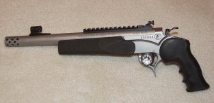

I also use the 48.0gr W296 load under the 240gr XTP Mag bullet in .460 Mag. My XVR is the 8-3/8”.
As I’ve mentioned before — I only have this rig for entertainment purposes. From a bench rest, I shoot at steel 100-400 yards away but by far it’s most use comes as a showoff to friends and guests. We’ll use it to split logs or destroy large fruit.

Using 30 grains of IMR4227 I get about 1750 fps out of a 12" .445 Encore and 1825 fps out of the 17".
That is one of 2 "standard" loads now in those guns.
The other is a Cast Perf. 260 WFNGC over 31 gr. I-4227 for 1822 and 1913 fps respectively.
I retired the Dan Wesson 7445 revolver awhile ago.
If they offered an X frame .445, I'd have one.
Velocities out of a 444 range from 1900's to over 2000 fps
Disclaimer:
These loads were developed in an Encore and may reach as much as 45 kpsi.
That is my normal limit for break and lever action guns in fine condition.
Dan Wessons may tolerate this occasionally but I would think twice about putting these in a revolver.
